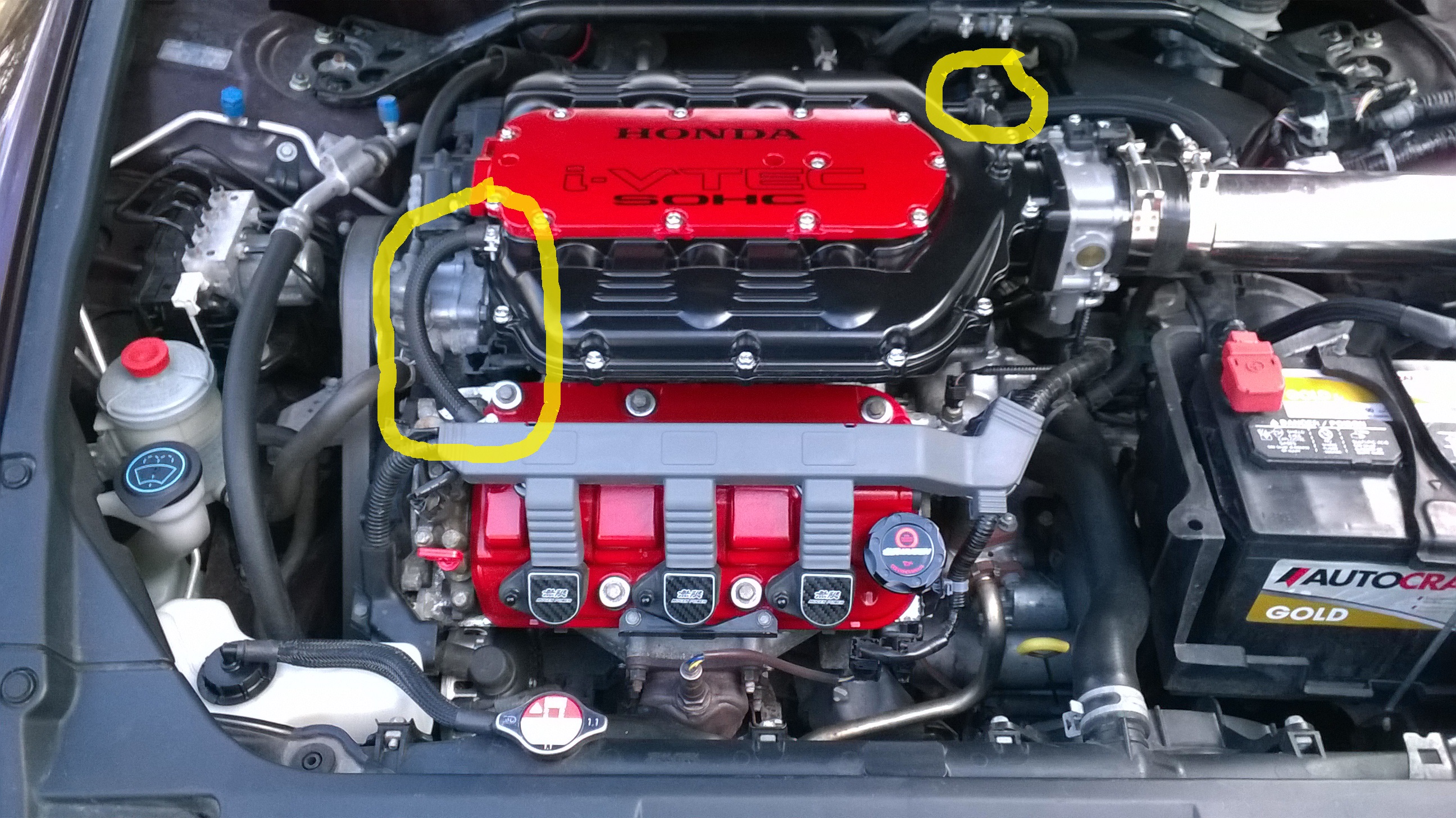

Finally got my 3.7L IM done
by @ccord10 » January 13th, 2015

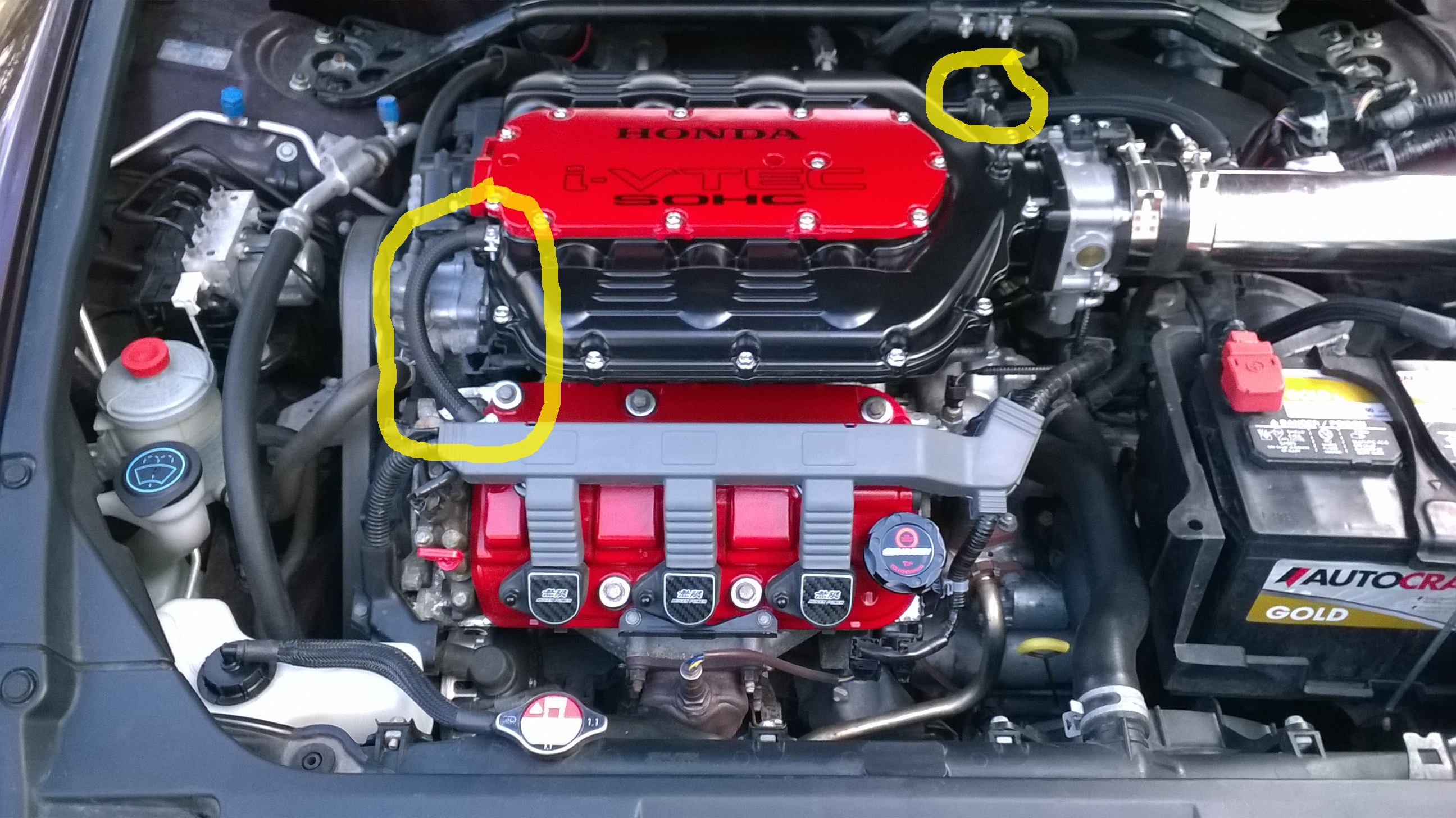

The hoses do get stretched pretty tight so i replaced 2 of them with silicone hoses , i circled them below. the one in the back is the bottom hose on the purge solenoid, also the throttle body wires get pulled tight but nothing to worry about. With the shorter P2R manifold riser they wont be as tight as with the factory riser which is like 1 1/2" tall.

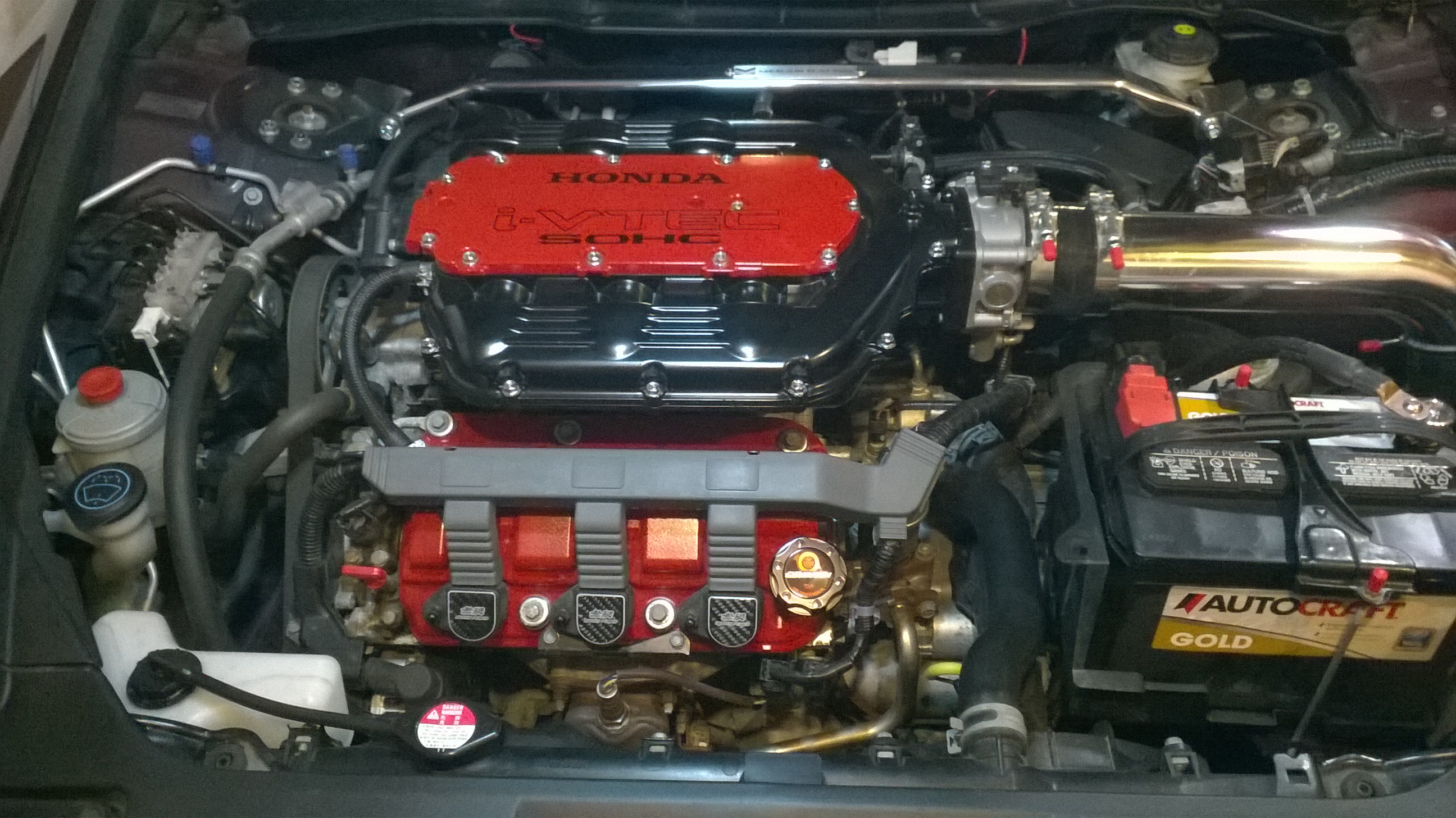

by @ccord10 » January 18th, 2015
Thanks! , most of the parts are from the TL like the front wire harness cover and the windshield washer fluid cap. part#'s
32132-RK1-A00 - HOLDER F, ENGINE HARNESS
32741-RK1-A00 - STAY A, ENGINE WIRE HARNESS
76802-TK4-A01 - CAP ASSY., MOUTH
The coolant tank cap and radiator cap cover is from an RL, part #'s
19102-RJA-J00 - CAP, RESERVE TANK
19106-RJA-J00 - JOINT, RESERVE TANK
19047-PLC-003 - radiator cap cover
I got the coil badges here
http://www.ebay.com/itm/261366895104?_t ... EBIDX%3AIT
i just got my Megan Racing strut bar installed and some silicone hoses.

Prob the most helpful thread i've seen in awhile. This is awesome man. I will definitely look into purchasing these items. How is everything still running etc? NO CEL? any dynos?
The car runs great, very responsive and the intake roar is louder now :) low end is where you notice it the most but it definitely helped power throughout the rpm band. this would probably help out more in upper rpm's if i had some exhaust mods but im still happy with the results. I ended up removing the IMT valve because it hurt high rpm's and mileage now its much better. no CEL's and no dyno numbers yet but im hoping to dyno it this spring/summer. this is definitely on my top 5 best mods for a V6.
