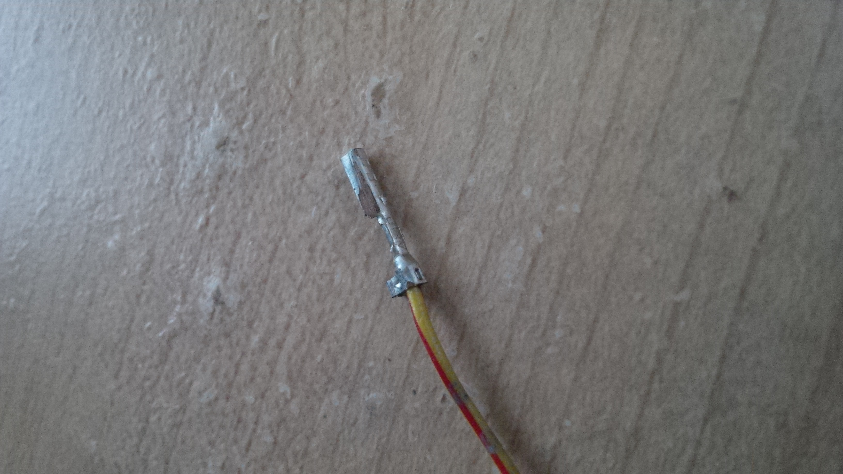

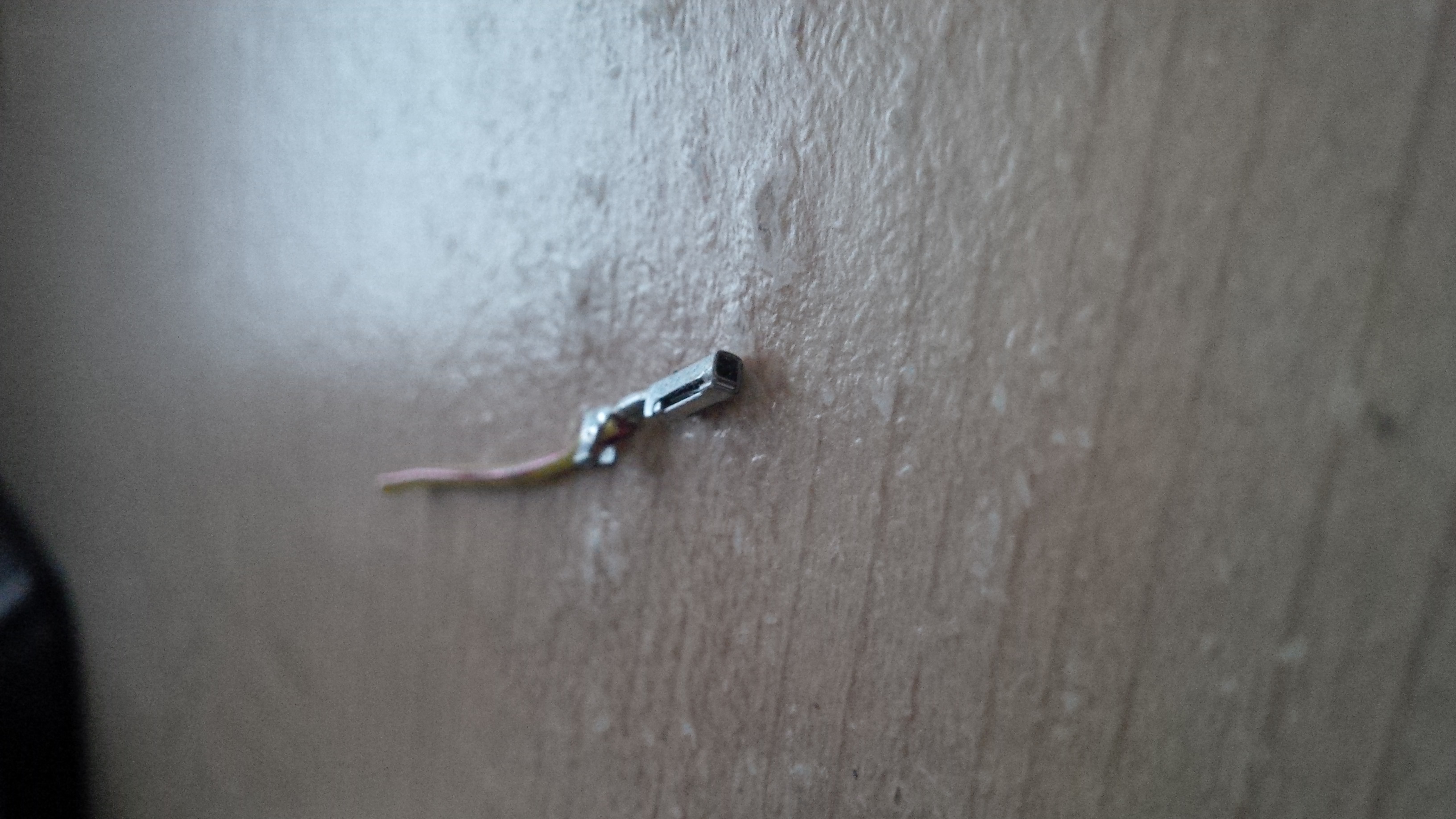

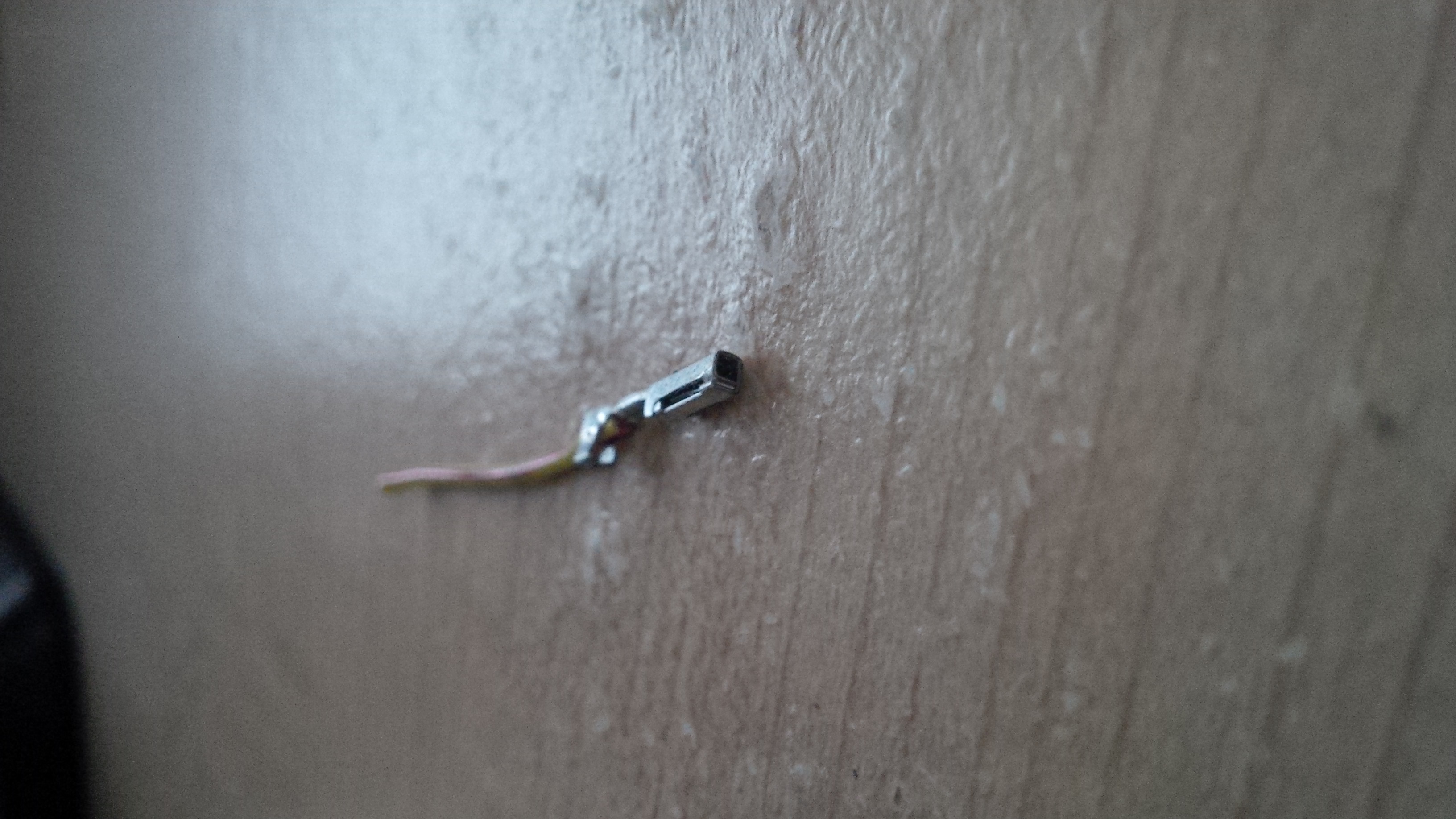

I wanted a clean install, so I headed off to the junkyard and cut off a few power mirror connectors from some Hondas as old as 1995. These connectors are exactly like ours, and my plan was to harvest the pins out of them. By doing this, I was able to solder on to the end of my pin, and plug my new "pigtail" directly into the OEM connector.
For the turn signals, I was able to tap into two wires in the drivers side main harness near the fuse box. Note: for some reason or another, the black wire on my passenger side mirror was not a true ground. I fixed this by removing the pin and adding my own new one with a ring terminal on it, and grounding it right there uder the sail panel.
ADD PICTURE OF WIRES HERE
The switch was a little harder to wrap my head around at first. I wasn't able to find an exact match on the pins that go into it's connector, but I found some that I was able to jam in there secure enough. Probably not the best way to go about it, but maybe someone's found the right ones by now. The switch works off of reverse polarity, which if unfamiliar like I was, do some research on what that means. Below I've attached the pinouts of the mirror connector, as well as the wiring diagram for the whole thing.
