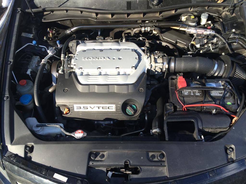

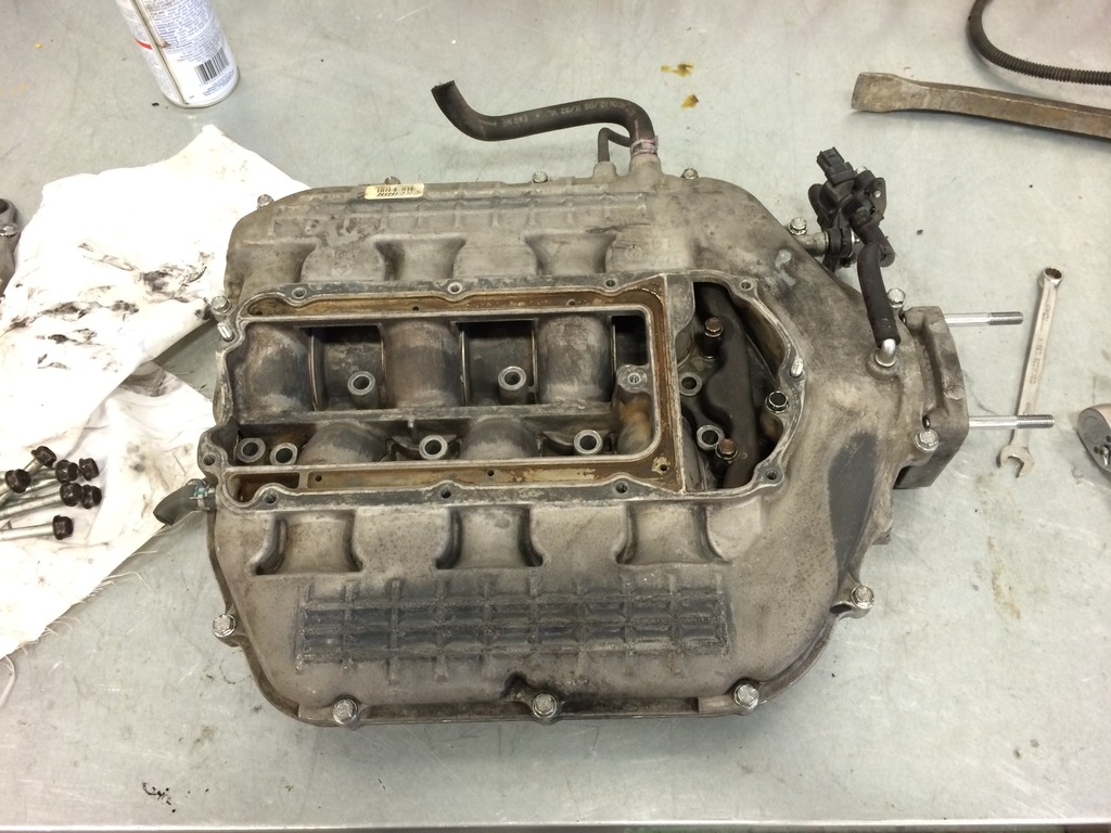

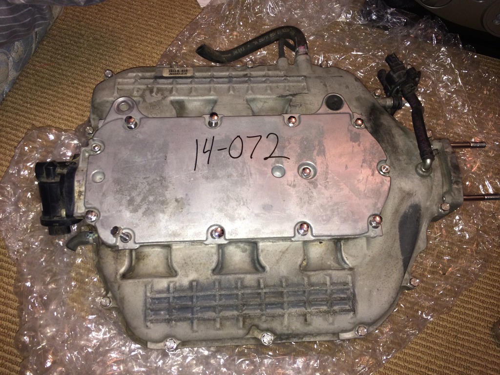

Like the title says im going to try my luck at this V6 upgrade. Thanks to @ccord10 for all the part numbers and details. I will be making another detailed thread too.

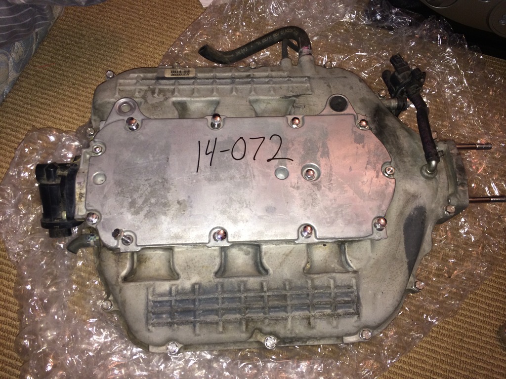

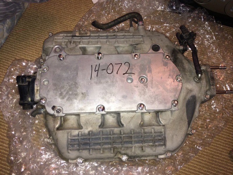

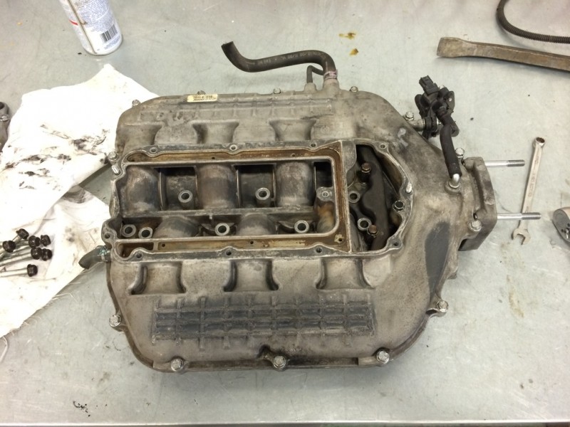

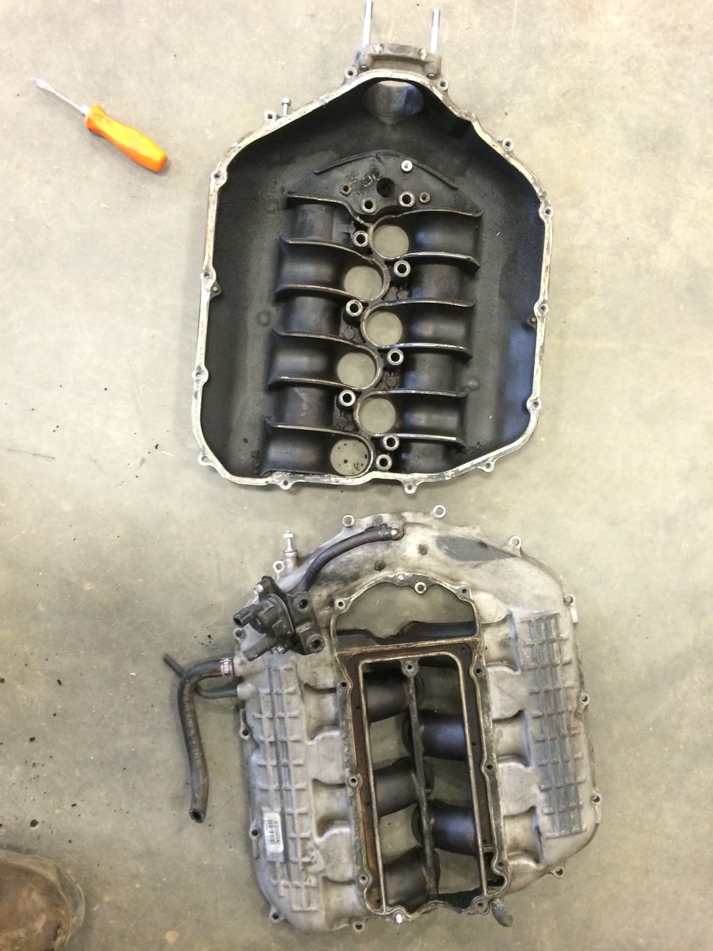

-Bought a used 2007 MDX manifold for $75 bucks plus shipping from AH parts dismantlers(totalled Acura MDX), so $91. All bolts/studs/nuts/ and the valve. AWESOME DEAL!
-I have a V6 6speed, I rather not spend the money on a P2R Riser, so i might go with the mdx one instead and use hood risers. Im curious to see how it works?
Ive been reading that the hoses are tensioned abit so i might purchase some new silicone hoses/make my own.

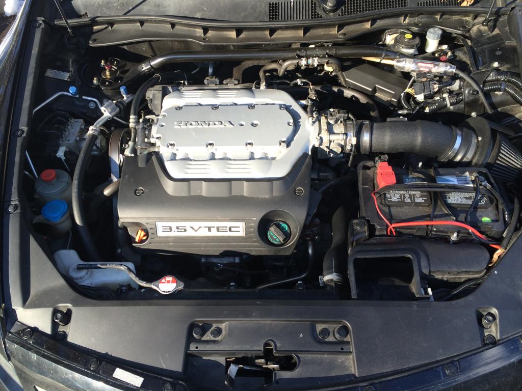

-I will be getting the following parts soon. I will Install all this when it gets warmer here in Virginia.
-I will be getting a dyno of my accord soon. It has a Magnaflow catback exhaust and Takeda SRI on now.

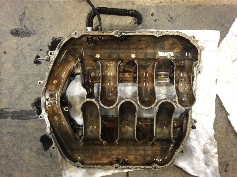

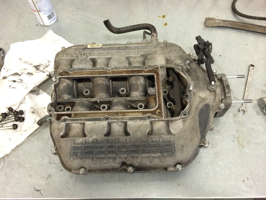

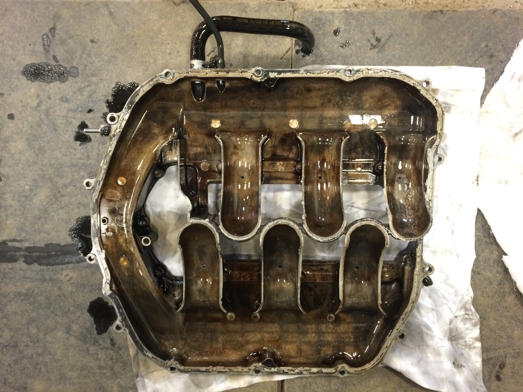

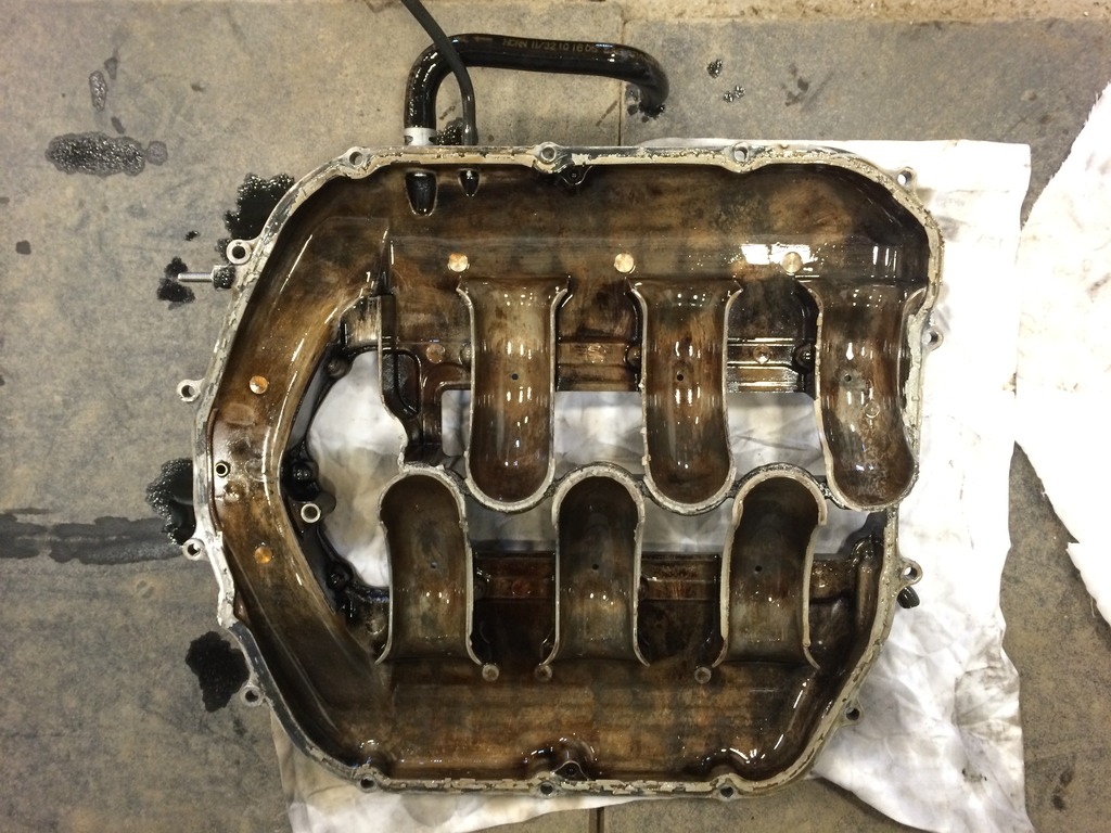

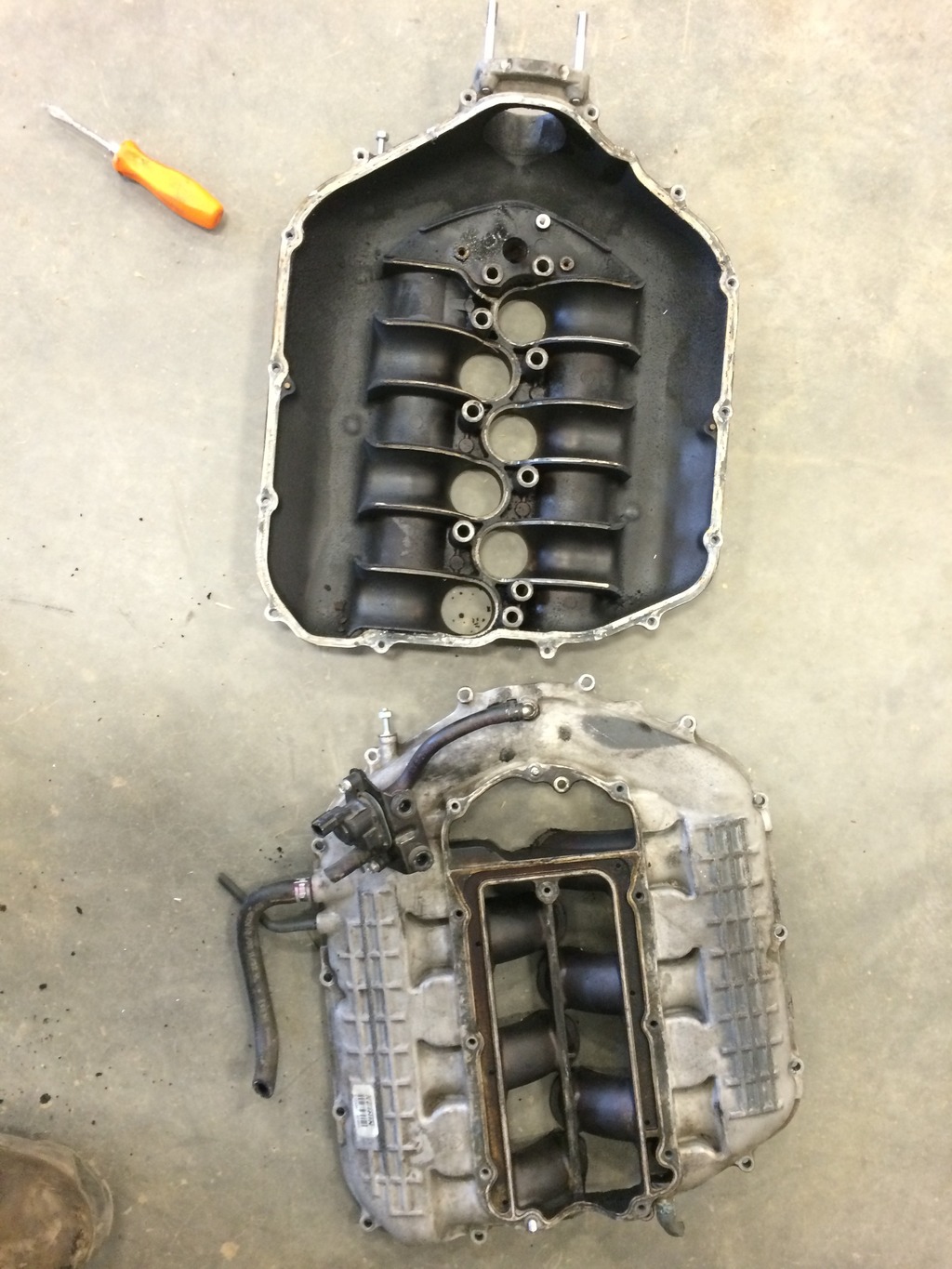

some cleaning

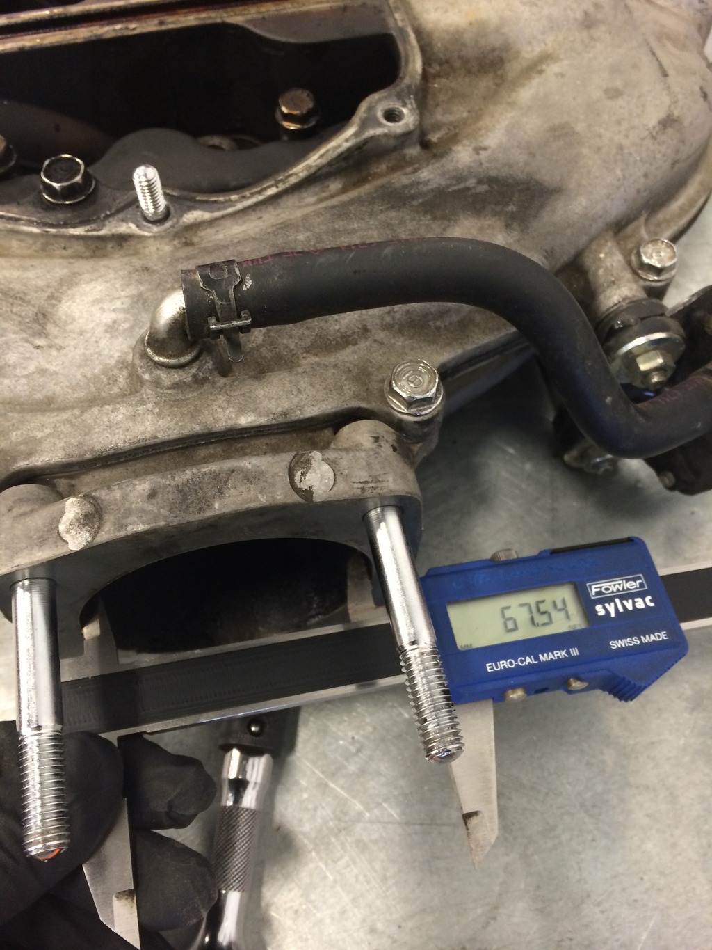

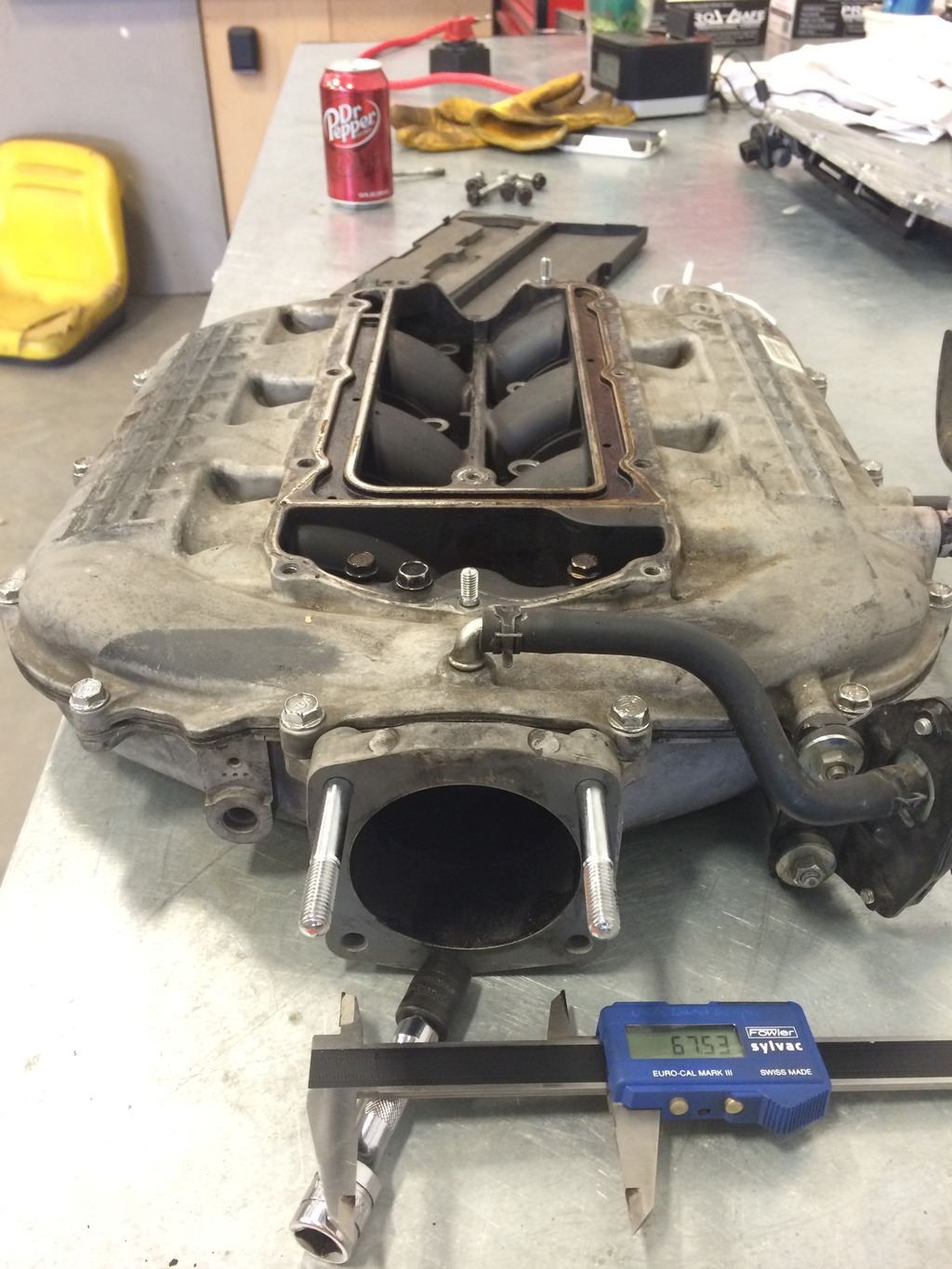

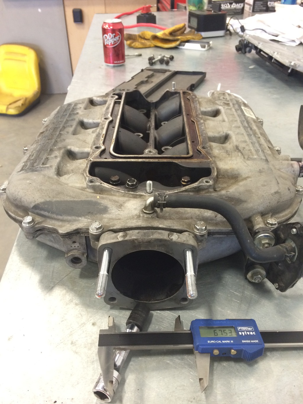

Now that i see the inlet is only 67.5 mm i believe that the 07 mdx manifold (even though it is the 3.7 liter) will not be much of an upgrade. I read here that this guy has measured his newer 3.7 and it reads 75mm... big difference.
http://www.v6performance.net/forums/7g- ... sizes.html
